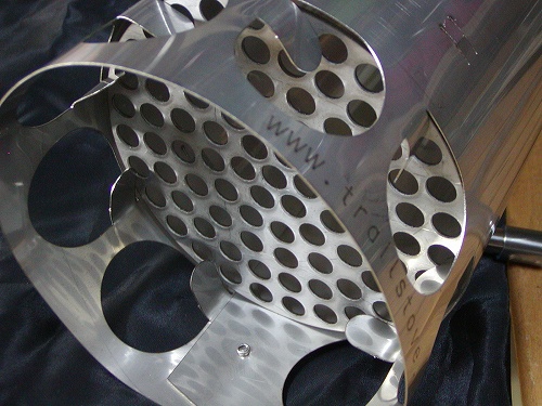

4.柴火炉的考虑:圆筒型设计的重量最减,方型设计明显次之,强度也不如;可以考虑上下两段式结构缩小收纳体积;应该有放柴的炉口和排烟道;应该架一层丝网改善通风提高燃烧效率。小虫是不错,但个人感觉用0.2的不锈钢卷个桶效果不会比它差

柴火炉高度不能太低,是否可以做成两节连接的款式呢
http://www.trailstove.com/details.html
http://survivaltek.com/?p=1055
How to use the TrailStove
1. Place the stove on even ground with the large exhaust hole on the side of the body facing away from the wind so that smoke will not go into the food to be cooked. Make sure there is nothing combustible nearby such as dry grass, wood, leaves, clothes etc
[/td][/tr]
[/td][td]2. Fill the combustion chamber approximately half-full with lightly packed wood. If the combustion chamber is completely full the performance will be poor. Place some easily combustible material under the combustion chamber such as a crumbled up piece of paper or some dry grass. Insert the blow-tube into the hole on the side of the stove.[/td][/tr]
[tr][td]3. Ignite the material under the stove. In a few minutes there will be a steady fire burning in the combustion chamber. The process can be sped up by blowing gently into the blow-tube. If the wood in the chamber is wet it will take a few minutes more before a steady fire is reached.
